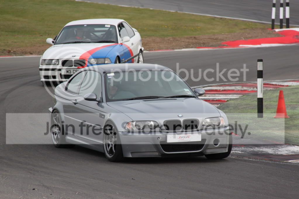

I originally trialed CSL rear rims up front et27 but 19 inch which worked on but anything belie -3 deg camber rubbed on the arch liner and nearly in the arch
now running road and track 265/35/18 all round with no rubbing at all
front are et37 with 3mm spacers (very close to springs)
Rear are et 15 all ok
car is running intrax ik2 which helps on the front as follower springs can be shortened so bigger offset can be used which means can run any camber up front road or track
With stock suspension depending on your geo will mean to get a decent road camber you may find Tyres touch wheel arch liner or wheel arch
